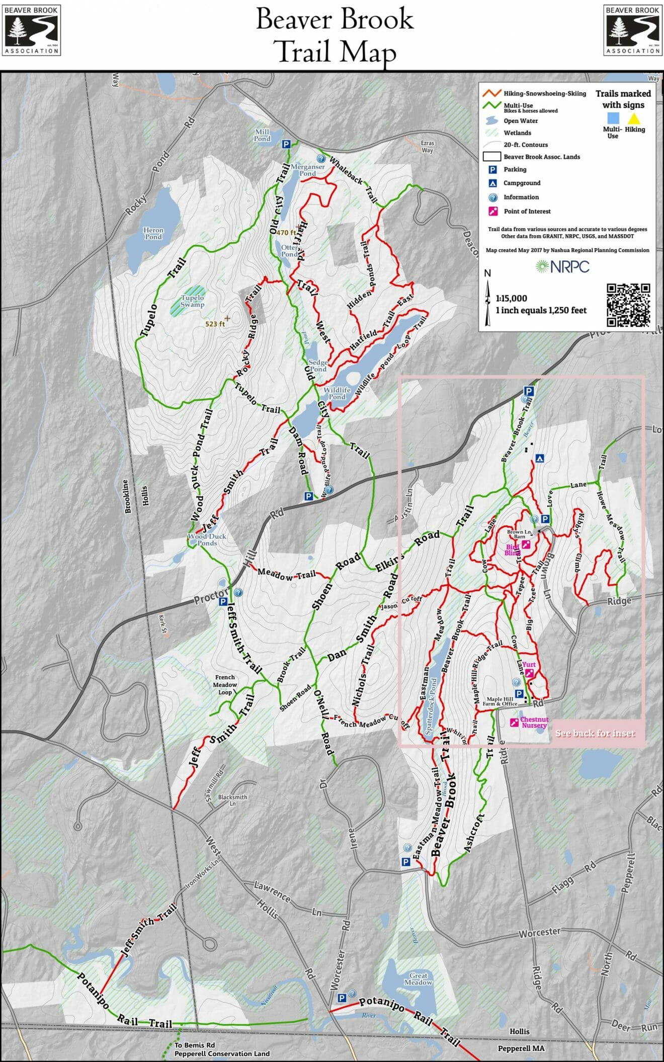

      The foxes will be in this general area:
      [caption id="attachment_41552" align="aligncenter" width="900"]Beaver Brook Association in Hollis, NH Beaver Brook Association in Hollis, NH[/caption]

      The foxes will be hidden very close to a trail. You will not need to go more than a few feet off the trail to find the foxes. The foxes will be well hidden, but in a fairly obvious hiding place – if you’re out looking for something that’s hidden, that is.

                Definitely interested.  For me, it would be better to actually do one as a group since I probably know the basics.  I’m just missing some tricks.  Maybe part of it is to have a map 🙂

                    Sounds like a plan, Fred.  I have done all that (except the body part).  But what happened this time is that I was getting a direction on the 3rd harmonic of #2 as well as getting #3 at 10KHz off, but I could never get the 3rd of #3.  I could walk along and get directions and strong/weaker, but I’m now wondering if maybe they were on a parallel path (I was on the Wildflower Trail).
                    #42342
                      Yes, it was right alongside of the trail behind the rock wall on the left. I bet you walked right by it. The toughest part is the last 10 ft or so. Let’s get together for the next one and we’ll hunt together.
