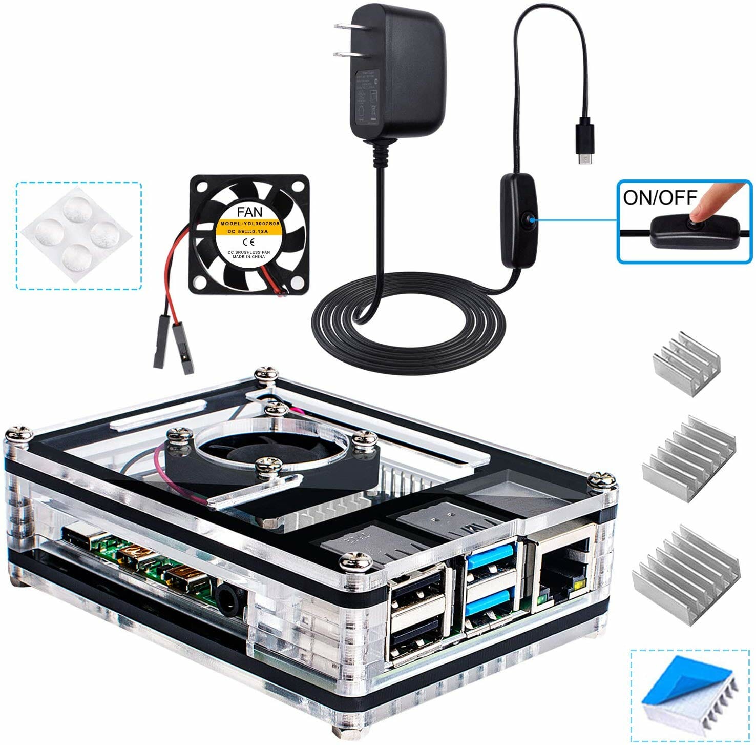

        [caption id="attachment_77410" align="alignnone" width="1476"]Raspberry Pi Case with Fan Raspberry Pi Case with Fan[/caption]
        Hi Hamilton,
        There are lots of good case choices. Here’s one that we’ve used with some good results.
        Raspberry Pi 4B Case with Fan
        This is the 4B version of the case that we used for our video players at HamXposition.
        Have fun!
