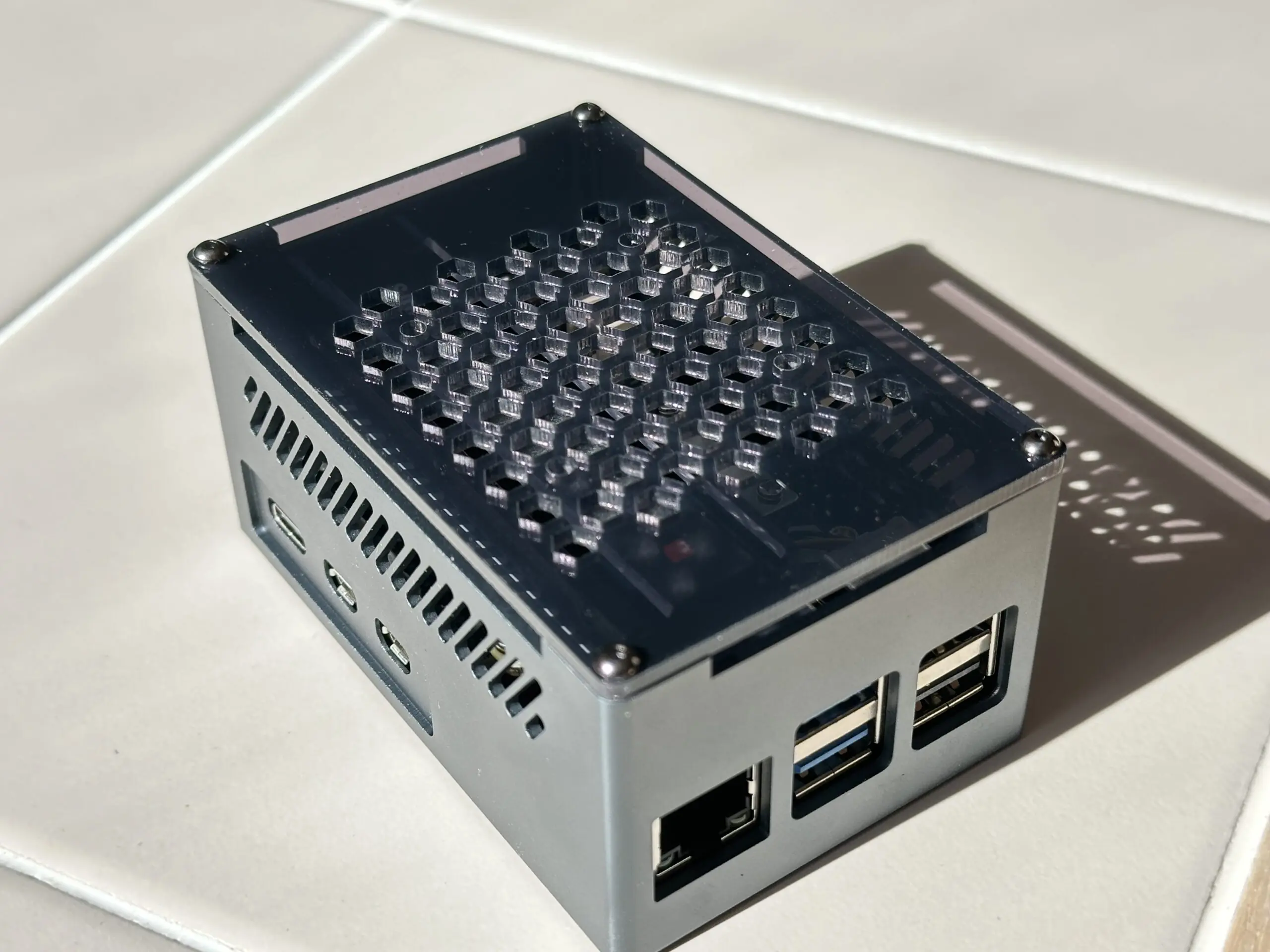

I wanted to start this thread to answer questions and provide help to members who might want to build a simple home server based upon a Raspberry Pi. We discussed how to get started with this project during our Tech Night last evening. You can find a copy of the presentation here.
I’ve also created a web page that explains what hardware is needed and how to set up a Raspberry Pi home server. You can view the page here.
We’ll complete the home server build at our tech Night in April. We’ll add a Media Server and some more web applications.
Please post here if you have questions or can think of applications and services you’d like to see us add.
