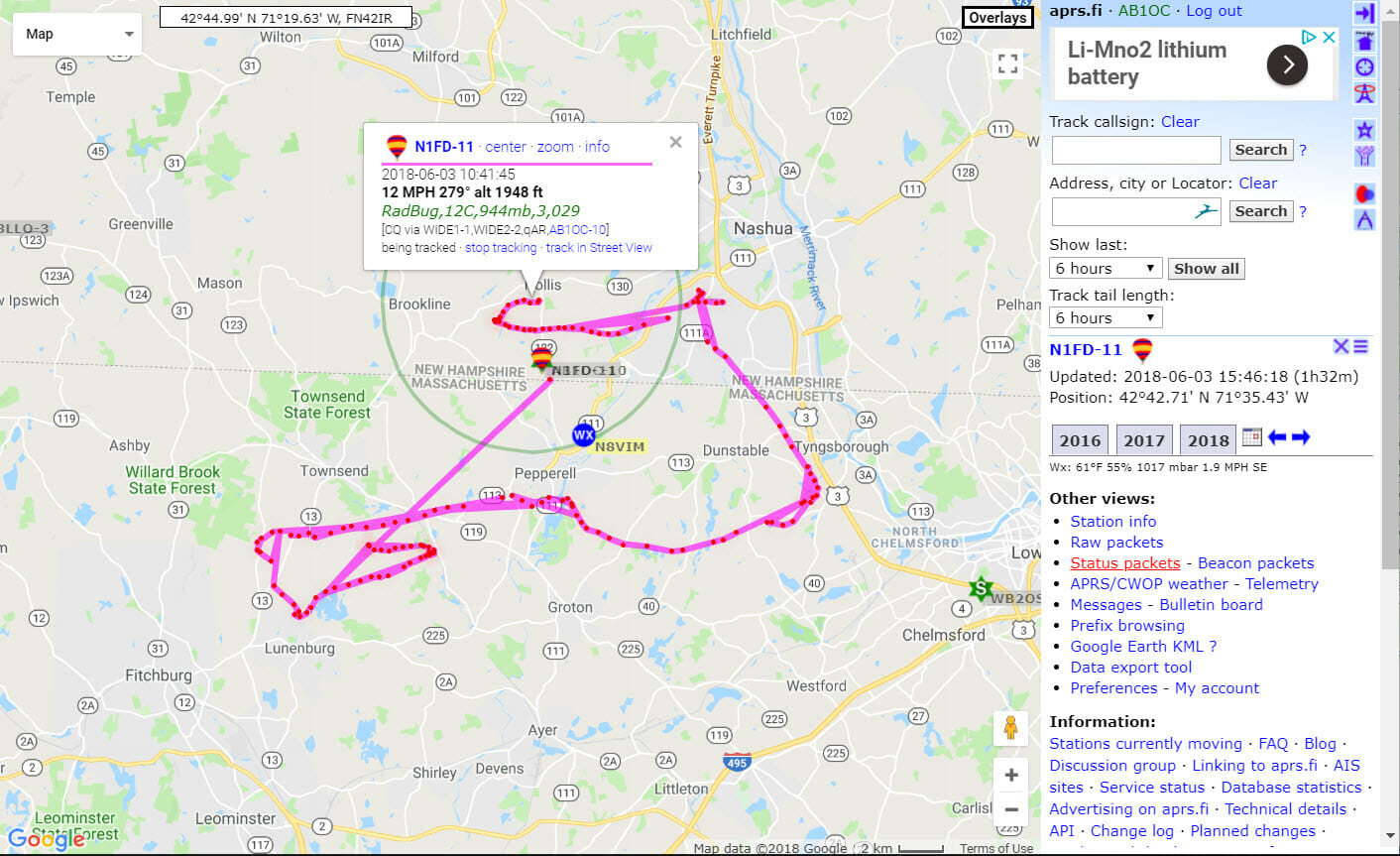

      The balloon burst at 114,815 ft asl. This was quite close to our predicted burst altitude of 110,000 ft asl.
      [caption id="attachment_43051" align="aligncenter" width="1412"]HAB-3 Actual Flight Path HAB-3 Actual Flight Path[/caption]

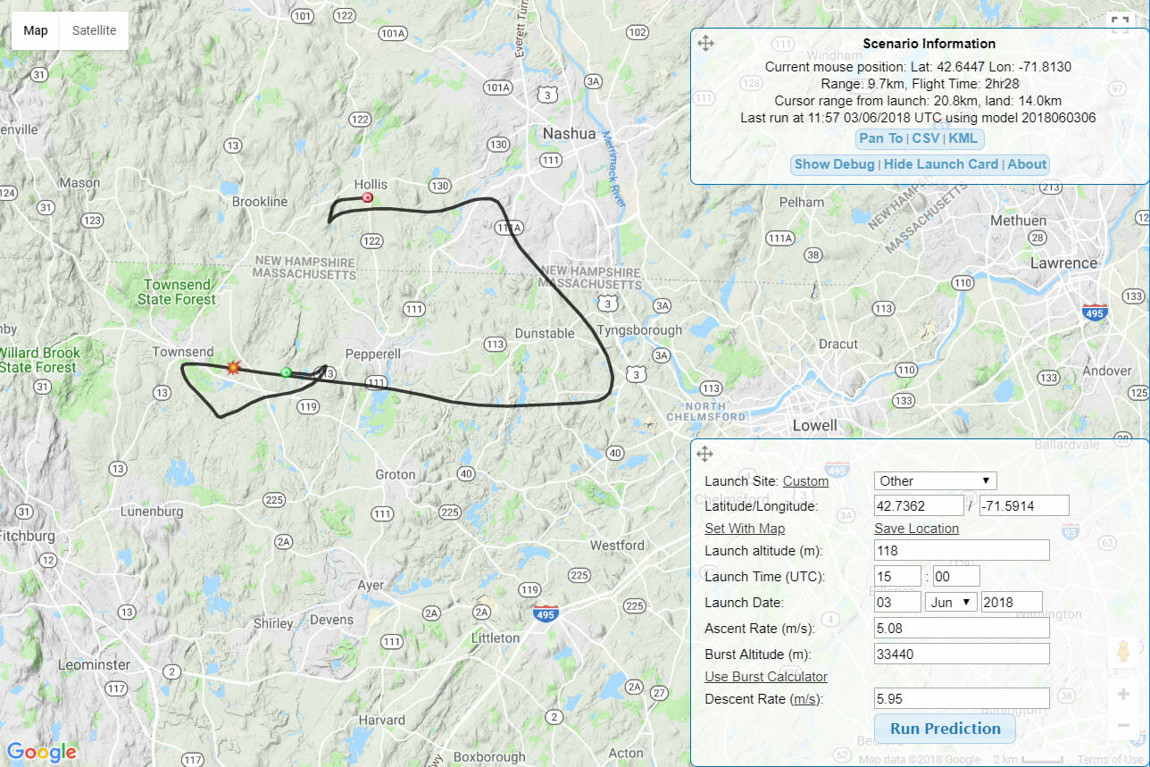

      Our HAB’s actual flight path (above) was also very close to the predicted flight path (below).
      [caption id="attachment_43052" align="aligncenter" width="1288"]HAB-3 Predicted Flight Path HAB-3 Predicted Flight Path[/caption]
