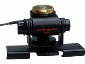

This arrangement will certainly work but you might want to also consider a lip-mount NMO on the top edge of your door.
[caption id="attachment_97731" align="aligncenter" width="300"]
Diamond NMO Lip Mount[/caption]I have this arrangement on my F-150 and it’s much easier to route the coax cable from the antenna to the radio. You can route the antenna coax it inside the door sealing gasket until you get to the hinge area then route the coax to your radio from there. The antenna is also mounted higher on the vehicle which will improve radiation performance. Here are some more pictures of the VHF/UHF radio installation in our F-150.
There are lots of good choices for NMO standard whips for this sort of mount as well.
