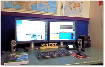

        Hello Duane,
        You might try entering “Shack” into the search box on our website to get some ideas on how to set up your shack.
        [caption id="attachment_98834" align="aligncenter" width="364"]AC1DC Shack AC1DC Shack[/caption]
        Also, here’s a picture of Jamey, AC1DC’s setup that is a nice one.
